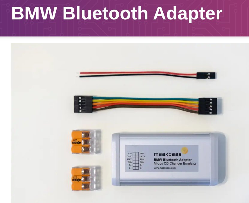

Janosch @, Dienstag, 24.03.2026, 12:16 (vor 184 Tagen) @ slo
Ich habe seit einigen Jahren den hier am Business RDS und der funktioniert einwandfrei.
https://maakbaas.com/shop/bmw-bluetooth-adapter/
Features
  • Good quality music playback by putting the radio in CD mode
  • Radio buttons can be used for play, pause, and next/previous track
  • Bluetooth volume can be controlled with buttons on the radio
  • Adapter remembers and tries to connect to the last connected phone
  • Some basic status information is shown on the radio display
The adapter does not support showing title or artist information on the display. The adapter does not support hands-free calling. It is for audio playback only.
